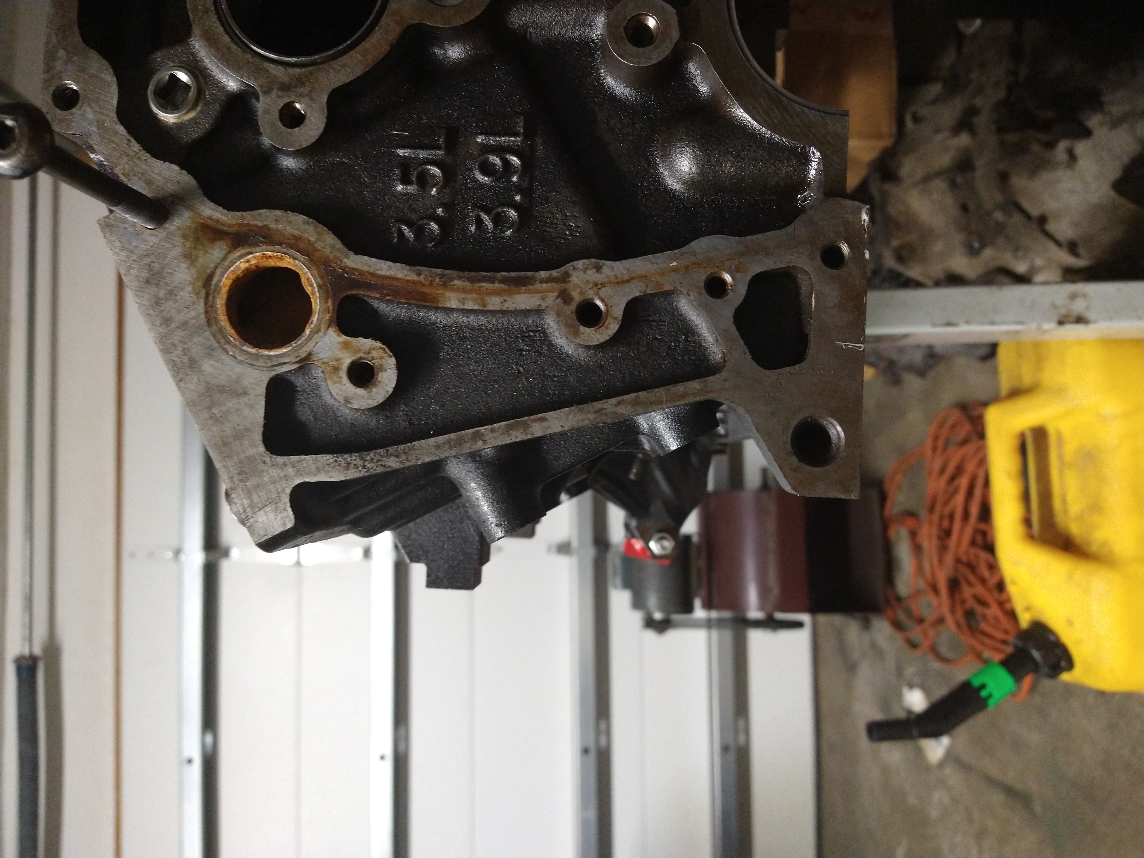

I wanted to post this pic here for front bolt hole location for Eric.

can you measure the distance from the oil pan rail to the bolt hole for me? that should tell the whole story by itself.Shaun41178(2) wrote: ↑Thu Sep 22, 2022 7:56 pm I wanted to post this pic here for front bolt hole location for Eric.

I dragged my LZ4 out of the corner, and snapped a picture of the mismatch, it's off, but it actually appears to be rotated off, maybe the boss on the side of the block is at a different angle? I'll have to measure it tomorrow.

I tried to get a center to center estimate since the bolt location for the front oil pan bolt is the same between the two blocks

Re: 3900 headgasket on 3400 head and other lz9 info
Yes I believe the boss on the side of the block is at a slightly different location, which will effect the angle
I believe this because I used my stock 88 front mount bracket on the lx9 I had and the front mounting holes lined up.
Also used the same 88 bracket on my lz9, and the lower bolt hole lined up, but obviously the second one just above is missing on the lz block

I still don't think that bolt hole is in the exact same spot. I think I'll revise my design to bolt the engine mount to the oil pan, hopefully that way more than one engine can use one mount design, this finding may mean I need 2 different alternator brackets, but I would most likely need to make 2 different mounts anyways.Shaun41178(2) wrote: ↑Thu Sep 22, 2022 9:35 pm Yes I believe the boss on the side of the block is at a slightly different location, which will effect the angle

I took the timing cover off of my LZ4, peeled the gasket off, and laid it on my LX9 block:
the bolt holes are in the came place, but some of them are smaller on the LZ
on each block, I put three bolts in, two in the lower timing cover bolt holes closest to the motor mount boss(es), and one in the mounting point that is being debated. I them measured the positions of the bolts relative to each other.
LX9
LZ4
the 1" mark on the tape is approximately centered on the head of each bolt it is over, it's not exactly precision, but close enough to show there is a difference in the position of that bolt boss relative to the timing cover bolts. I also measured the angle of the block side bosses, they're 60 degrees from vertical on both blocks.
LX9
LZ4

I do have a set, but they weren't in the garage with me, and I didn't feel like making another trip. this was accurate enough to show there is a measurable difference.

Isolating variables, I didn't know if the block side bosses had been changed.The Dark Side of Will wrote: ↑Tue Oct 04, 2022 8:38 amDid you think your mount bracket wasn't enough?ericjon262 wrote: ↑Mon Oct 03, 2022 5:29 pmI do have a set, but they weren't in the garage with me, and I didn't feel like making another trip. this was accurate enough to show there is a measurable difference.
