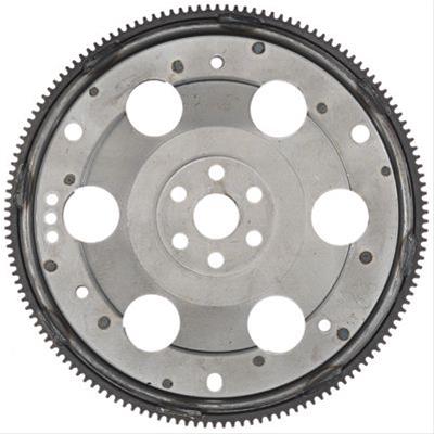

Here's a quick model of a matching flywheel with the Northstar crank pattern, sized for the 282.
I will need to update the counterbores for actual measurements, since they're currently ISO standard--which means socket caps, I think.
I'm going to grab one of these: https://www.summitracing.com/parts/atp-z253
The OD of the puck is 8.400. I'll hollow out the flexplate to 8.400 and weld it to the perimeter of the puck. That cut should be somewhere in the diametral range covered by the speed holes, which will simplify the welding.
Once figured out, this basic technique would work for any application using the 282.

Here's my flywheel in progress:
Welded:
"The perfect weld is always a millisecond from disaster"... Note the bulging on the front surface from the welds on the back surface.
The flywheel ended up right at 11#, which is heavier than I'd hoped, but I deliberately left a bunch of extra steel in it to soak up heat from slipping it in traffic. The most important 3#, the band around the perimeter, is GONE, so that's a big deal and should make this unit spin up quicker than an 8# aluminum unit.
The stock clutch assembly consists of a 14# flywheel, which is already pretty light, a 14# pressure plate an a 3ish # disk. That's 31#. With an 8# aluminum flywheel, that's still a 25# assembly, but with potential reliability problems from the aluminum flywheel.
I'm not exactly sure what the TIlton's final assembly weight is, but even at 10# for pressure plate and disks, the entire assembly would be 21#, which is not only 4# lighter than the stock type assembly with an aluminum flywheel, the smaller diameter gives it SIGNIFICANTLY less moment of inertia, so it will spin up MUCH faster than any stock type clutch/flywheel assembly.

There's an LS4 flexplate in the junk yard 3 miles from where I work. I'll pick it up so that I'll have an actual unit to measure.
FieroGuru's starter mount *MIGHT* clear the Fiero Getrag throw out shaft. I'll have to look at the pics vs. a bellhousing and see.
https://ls1tech.com/forums/ls4-performa ... ssion.html
