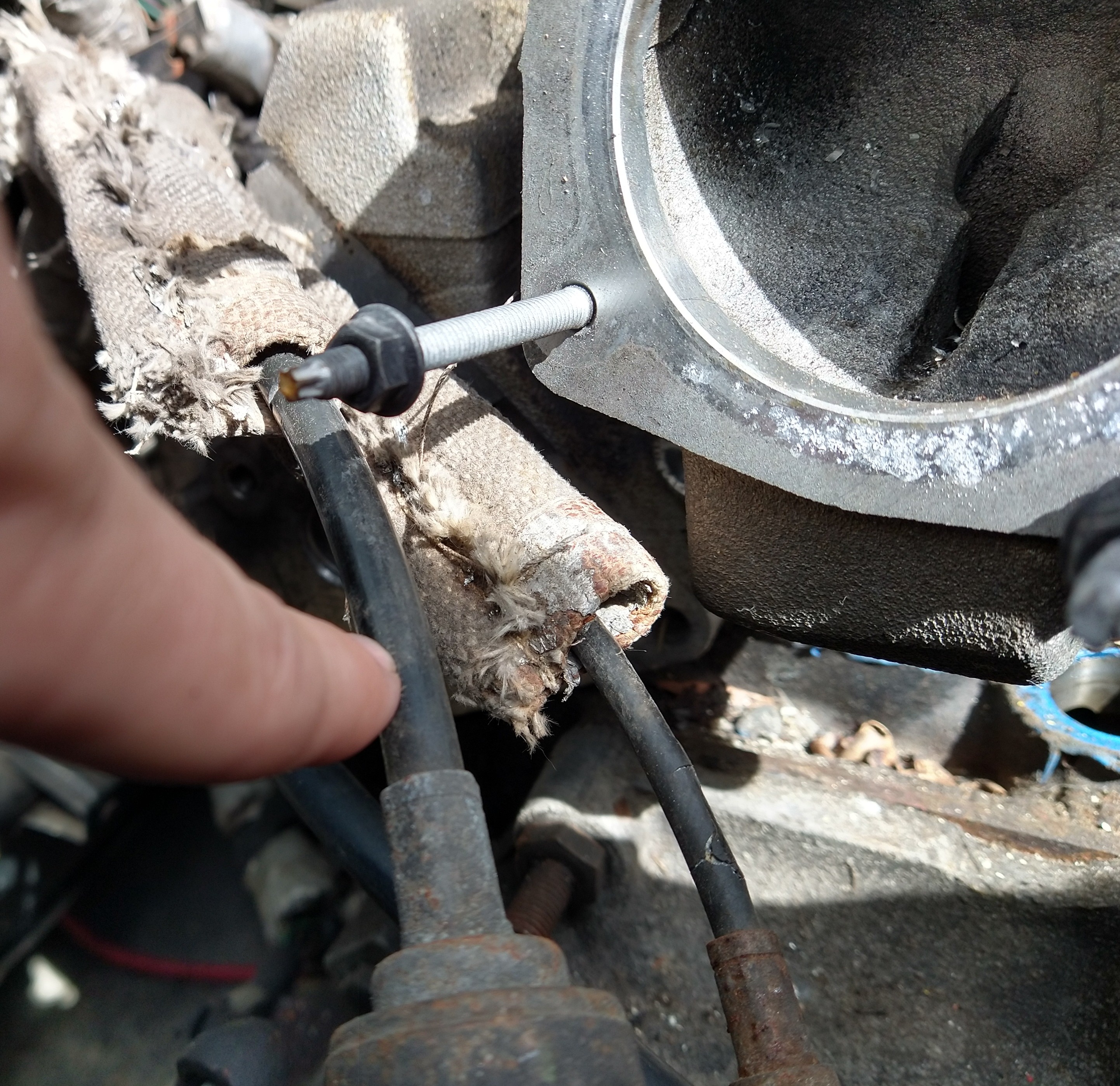

Doing this swap for Howard. Initial mock up shows there might be a clearance issue with the shift cables for the trans, once the adapter and tb go on. We shall see.
I'll post more updates as the swap progresses.
