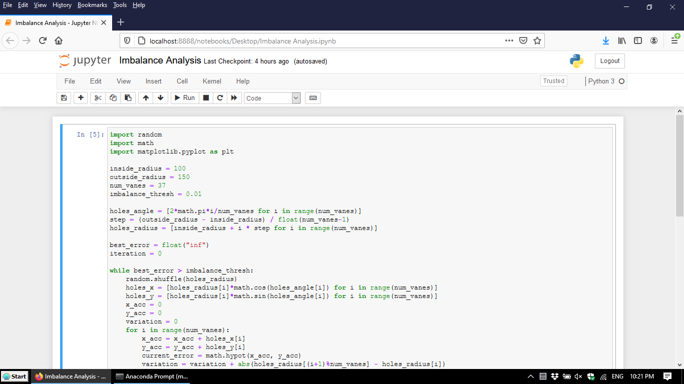

Here I am doing a simulation. I am considering drilling my brake rotors with holes drilled between the vanes. 37 vanes = 37 holes. 37 is a prime number, so I cannot repeat a hole pattern to ensure balance (that would be too easy).
So up top, I write some code; it's randomly rearranging hole positions, and finding the resultant centre of mass of the holes:

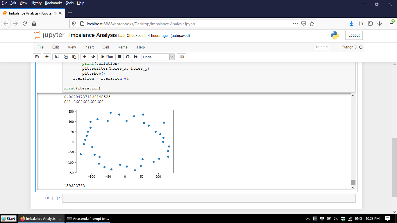

Here is a result obtained after all afternoon trying things:
Scrolled down.png (54.98 KiB) Viewed 7121 times
So that's like having an imbalance of a drilled hole 0.002 mm off-centre.
It took 159323763 iterations to find this result.
